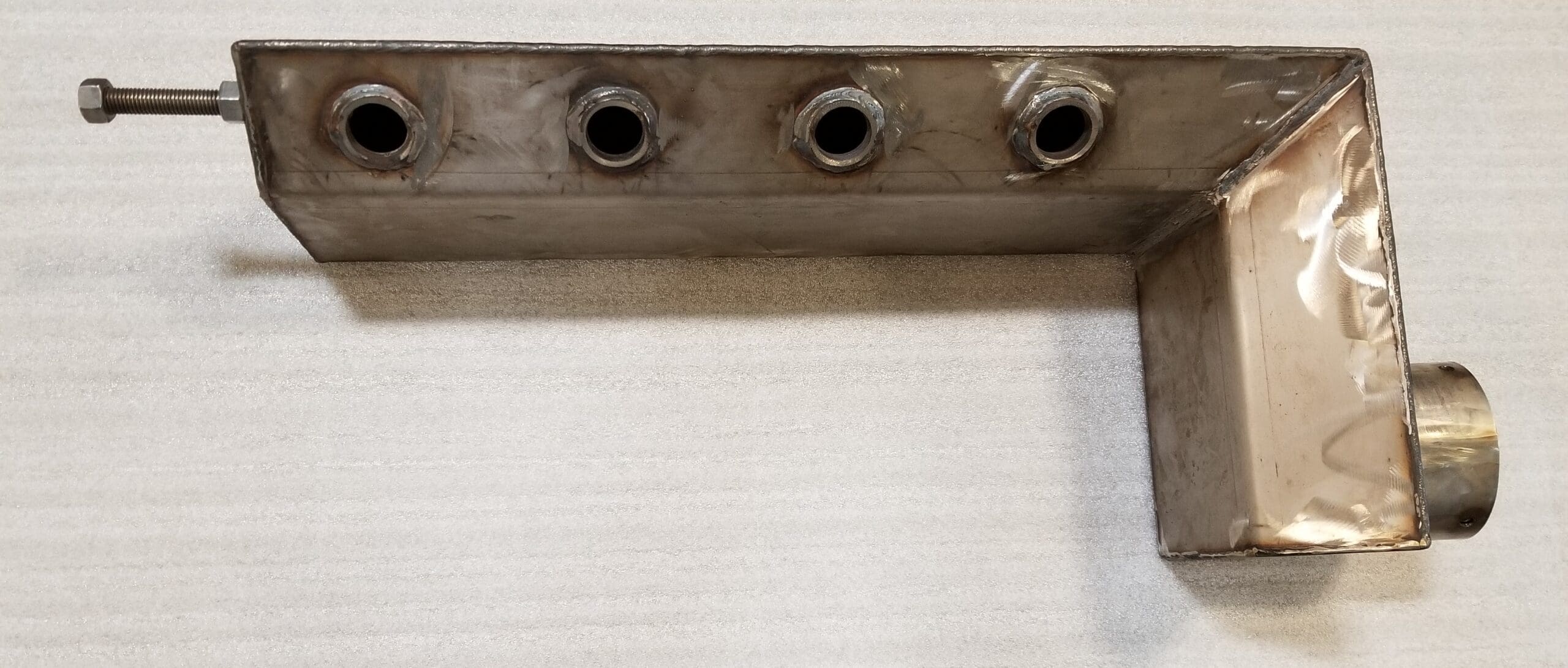

I finally had time to install the new door seal kit from AHS. Getting the old one out and thoroughly cleaning the door with a few hand tools and a wire brush on the drill took a while.
I then installed the new air diverter. Newer item Alternate Heating Systems (AHS) makes to prevent huffing and puffing. Large intake pipe on back slides tightly into the air intake at the back. 4 Holes along the bottom down the left hand side of boiler. 4 Holes along the top as well. Three have plugs you can take out or leave in depending on moisture content. The higher the moisture content take more plugs out.
I have to wait a couple days for the high temperature sealant to cure. Then I’ll see how it works.

For the other Wood Gun owners who don’t know about the air diverter. They make several sizes. Suppose to increase efficiency as well. We will see how it works soon.
Interesting...seems pricey for what it is...probably time consuming to make though...and probably relatively low volume.

It is pricey! I hated to spend that kind of money on it. But I’m hoping it will be worth it.
This is what AHS says about it:
Say goodbye to back-puffing on the Wood Gun! This stainless steel air diverter tube mounts inside the firebox with ease. It was engineered to fix back-puffing, create a more efficient burn, while using minimal fire box area.
it greatly prolongs the life of the air valve disc in the air valve, it preheats the combustion air for better efficiency, eliminates wood bridging in the firebox, and allows the wood to burn more evenly in the fire box
We shall soon see.
Make that five holes along the bottom and four along the top. LOL
We shall soon see.

Gone to full wood heat as of Friday night. Appears to be working nicely!

I will follow this closely as I really would like to put an end to the puffing. It doesn't happen often, but it's a PITA when it does.
I still get some occasional puffing. But it is less. I believe I need to make some adjustments with my air intake now. And maybe not burn wood that is TOO dry. My White Pine gets that way after I have stacked it outside for a long while. I have to be careful not to put too much of it in. Mix less in with better hardwood.

So, how's the air diverter working for you? I had some puffing in past years but have started to split the wood larger and that has helped with the puffing but they tend to bridge more poften than the smaller splits. I'm debating on the diverter.
It has not totally eliminated the huffing and puffing. But it has reduced it. What continues is not much, and manageable. I’m going to try removing the last plug and see how that helps. I also believe that my White Pine firewood is too dry, for what this burner likes. That causes what remains. But, I like burning dry wood. Keeps the creosote away. I don’t get the huffing if I’m only burning good quality hardwood though. I also am going to experiment with a few other things. Split size. Air intake. Etc

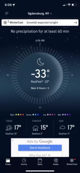

This is the Danfoss ESBY return valve. I had to pull the thermostat out of it(seems I lost the picture of it) and put a new one in. This gasket maker help seal it up nice where the old one had deteriorated. I used a wire wheel on a drill to clean up surfaces and then put this on. The system has worked great ever since. With many days in the -20s and one at -33, I’m glad I’m not burning oil!

Here is a shot of it from the supplier….[Hearth.com] Preparing for season 11 with the E100 Wood Gun.
