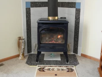

My $150 propane backup stove. Have a propane stove in the shed for when my 73 year old mother gives up on feeding and tending the AES magnum.
  • [Hearth.com] "Pretty" pellet stove recommendations
