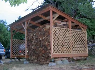

A wood shed, correctly oriented and ventilated so that the prevailing wind can blow through it is a huge blessing. There are several threads here in the wood shed forum on this topic if you need inspiration. Ours holds 6 cords. I'm going to build a 3d bay onto it this summer to house the splitter and mower.

begreen lives in an area of the country where it's pretty humid (and not much wind according to the maps.)
You'll get the quickest drying if your wood is stacked loosely in single rows so the wind can blow through it. Many folks will dry their wood like this, then put it in a shed (where the air movement isn't as good,) after it's dry.

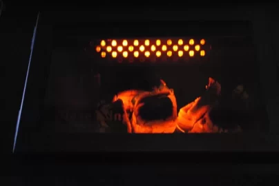

Do you see it( the cat) glow a bright orange?

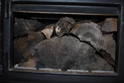

This is what a full load in a Princess should look like. When you read about long burn times this is how we load them. Wood is stacked decently tight and very little space is wasted.
Full Load

Glowing Cat
sometimes it glows bright orannge. most of the time a dull orange

If it's glowing, it's hot. What is the stove top temp at this point?
