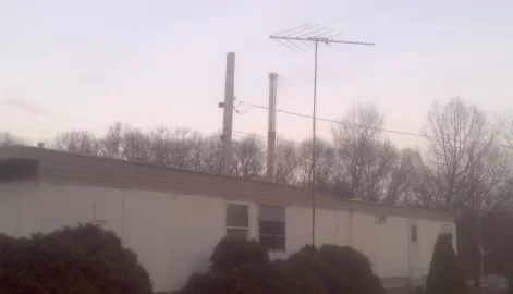

Yes, there is going to be a lot of leverage on that tall pipe. I would start by adding a 3ft section. Be sure to install a brace or two on the chimney pipe. One is required at every 5' above the roofline.
Oftentimes, the mobile has no attic but just a thickish roof which includes the ceiling, insulation, and roofing. Kinda like a rafter setup. Low ceilings of course since this thing has to go down the road. If the stove is installed near the low side of the roof then you can have an ultra short chimney that meets the 10/2 rule.

well here she is hard to tell but its between the the antenna on a telephone pole. Still needs tie downs. More to be revealed as far as temperatures in time burns.
