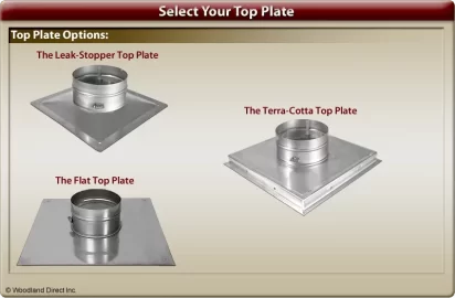

Can anyone provide a picture or diagram explaining exactly what the top plate is and where this seal should be with the chimney so I can check my recent install?
Here are a couple examples of top plates. They vary according to the installation. Most big liner company sites have detailed instructions.The seal is on the bottom of the top plate, where it meets the tile chimney liner or chimney crown.

I still have to climb and check if my top plate is sealed but if it isn't why should it be sealed? Those plates look like they overhang enough to act like eaves and direct any water away from the chimney crown.
It should be sealed to keep moisture, rain, bugs, etc. out of the chimney and to keep warm air in the chimney. The top caps with the bent down edges do the best job at this.
My top cap is the terra cotta top plate design that has deep sides which overhang the chimney crown by 3/4" on all sides. The top plate sits on top of the chimney and I don't think there is much gap at the contact point to caulk. It would be a reach to lay a bead inside the deep sides where the plate rests.
The installer didn't caulk between the two an I'm think the terra cotta plate provides the most weather blockage.
Yeah I didn't caulk my terra cotta top plates. No need for it. When I was using the flat top plates I caulked them.
