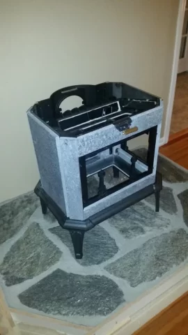

Yesterday was the big day. Getting the stove home and off the trailer wasn't too difficult with a come-along but the original pallet looked like it was damaged in shipping and the shipping company put it on another full sized pallet which put a few kinks in our plans. This thing is heavy and two people could barely budge it on a slick steel trailer bed.
We had rented an electric stair climbing dolly but that wouldn't work with the larger pallet. In retrospect I should have just dragged the crate off of the new pallet but at the time decided that taking the stove apart to reduce its would be easier. The main concern was that the back end falling off might damage the stove. I could have put a 2x4 scrap underneath to step it down but hindsight is 20/20
Taking the top and side trim off the stove was easy enough but anything inside of that has some sealant applied to it and I didn't want to break those seals. But with the top, doors, bypass door, some interior soapstone panels, and glass removed it seemed barely light enough to lift up the stairs with 4 people. I went out and bought two sets of shoulder harness moving straps and started texting neighbors. Once the top of the stove is removed I think the main firebox is not attached to the base so put some ratchet straps around the whole thing to keep it together.
Me, my wife and two neighbors, equipped with two sets of shoulder dolly straps, were able to get it up the 6 stairs and onto the hearth with plenty of grunting. It would not have been possible without the shoulder dolly straps. We did put a couple small scratches in the side soapstone but there is probably some solution to make them less visible.
Anyway, my wife and I can get the final placement and reassembly done today and then it's time for the chimney install.
Oh, if you ever need to remove the glass you'll need a 12 pointM8 driver bit. That took a special trip and I had to buy a 100 piece set but now I must have every driver bit known to man.

Shes all put back together now. Here is a bunch of pics of the internals and some tips in case anyone else decides to shed some weight to move one of these beasts.

Threaded rods that hold the top on. Tighten these last or you deform the whole thing and make it difficult to install the window or corner trim. Be very careful removing the window as the panes can fall out. There is a youtube video of how to replace the window, watch that first. But one difference from the video is that it looks like they started gluing the upper soapstone panel to the fire box so you don't need to worry about that falling out. Be careful though and don't assume any of the soapstone is glued on until you can verify it. You need an M8 12 point bit to remove the window surround.
[Hearth.com] Progress Hybrid Install and Experience
The cleanest the firebox will ever be. The back soapstone blocks can be removed by sliding them up and pulling from the bottom.
I have a before pic with the rear heat shield bit forgot to take an after. Ill do that and post a pic tomorrow.
The ash pan and heat shields went on with no problems and no extra wood support was needed. Just follow the directions and hold one end up, get a bolt or screw in, the do the same on the other end.
