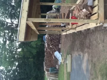

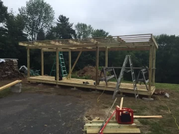

More pics and details to follow... Great website for ideas and great family for pitching in!

Nice shed! What did you use for perlins?

Thanks for the likes...been wanting one for a loong time! Specs are 24' long (3 8' bays), 4' wide base and 8' front, 7' high rear. will accommodate 3 logs deep or 4 with just a little overhang which is fine as steel corrugated roof has 2' overhang. open floor spacing (not enough to let a foot through) to aid drying. Under $800 all pressure treated, lagged, screwed and nails, concrete pads. Next year will stain and decide on trim.
Looks sharp. Mighty sharp.
Tsk, tsk. Granted, it's only nails and screws but it's still drinking and driving. ;) Seriously, great-looking shed. :cool: I don't know much about it but would there be any concern with the footers sinking unevenly?
True, the weight isn't on the ground, but on the structure.
On another note, might not a wood shed be a good place for solar panels?

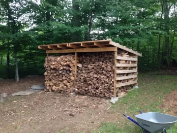

Beauty! Built basically the same thing myself but added 2x6 cribbing around the outside. My wood is on landscape timbers on the ground. I'd be worried about supporting the weight on the structure. But the design is solid. Wish I had room for a third bay like yours! Well done.
Very similar indeed. I looked at many of the pics posted on Hearth.com to get ideas. I too will be adding cribbing to aid in stacking an like yours, want as much air circulation as possible. My shed is faced east and west. If the air comes in as a N'Easter in Jan, I will be burning inside!

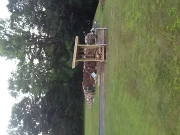

2x6 pt construction. I used 2 each, 4" - 3/8 lag bolts and liquid nails for good measure in to the 4x4 posts.

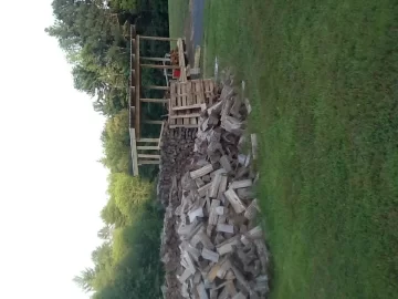

Wonder if the kids will be back to help stack? I have 6-8 cords - hard to tell. If I go 4 rows deep, I think I can get 5 - 6 in the shed. The stacked wood is 2 years.

Nice shed! Looks like you have a great helper too. My wife was nowheres to be found when I put up ours.
Looks good. DOnt want to be a buzz kill, but if those floor joists are only on 4' centers, they will sag under load of the wood.
