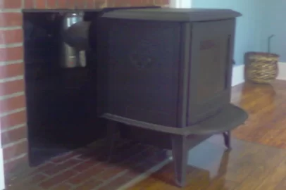

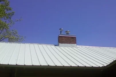

Install completed. excellent draft on first fire (75* outside afternoon, small inital fire). Full burn the next evening, was amazed at no smoke visible on both open burn and 1/2 throttle. Looking forward to a nice warm home on our bone chilling 43* rainy nights and mid 20's frosty mornings and very small LP bills.
Thanks for a great forum to get help from!

I can't tell, it looks like there is something between the front legs of that stove and those beautiful wood floors, but not sure. If there is something, what is it?

That is a 3/8" Tempered glass floor protector under the stove (1" cement joint between brick hearth and wood floor that glass sits on).
Those are original 1930's Heart Pine floors from my great grandfather's sawmill.
I live near Tallahassee but this is still GATOR COUNTRY!
Keep an eye on the flooring under the glass. There is a lot of heat radiated downward from the glass on EPA non-cat stoves and some people have reported damage to their hardwood floors from the heat in front of the stove.
Besides the downward heat radiation, I would be very concerned about heat transmission through the glass from any spilled hot embers.
Al
On the Morso, there is almost no heat radiated downward, in fact the space below mine is almost cool.
I can't say I have much good to say about your choice in Universities but I do like your choice in stoves. :)
