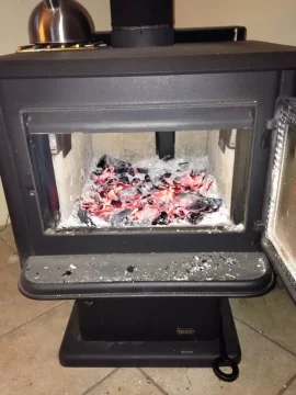

[Hearth.com] Pulling the triggerhere is what I have to work with after my last reload last night. This is a 10 hour burn of Doug Fir and Maple.
Very nice for once a quality stove and not a drolet
