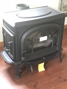

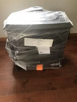

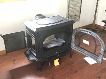

Finally purchased a new Oslo today. Asking price was something in the range of $2470, $2700 something for delivery. Made the deal at $2500 with delivery included, which I thought was reasonable. New in the box, matte black with the decorative face.
Place I went to in NH was pretty much hassle free. I could tell they were slow for the season. It was really a quick in and out, easy purchase.
I have the next few months to construct the hearth and install the chimney before winter. I’m doing it solo, to code and will need it inspected by the town fire department for insurance. So expect to see some more questions from me in the coming weeks.

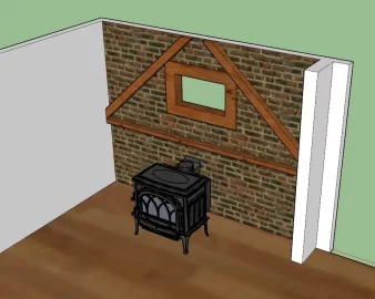

What if there's nothing on the other side of the wall but another open room? This is a 109"(wide) brick wall that separates the kitchen from the living room. It's only one course thick. There are some exposed timbers running through it, but they're closer to the top.
Currently there's a poorly placed sink and dishwasher in front of it, but I've attached a fairly accurate model of what it would look like. Aside from the framing around that little window, those large timbers go clear through to the other side of the wall. But there's nothing on that side but another open room (living room).

Going straight out the back locks the flue exit height to the thimble which may work for the Oslo, but not for a future stove choice. Instead of going straight out the back of the stove with the stove pipe to a thimble, what about going either straight up or up and then to a 90º thru that opening with a class A tee?
I’d be running the stove pipe straight up from the stove out the ceiling. That little window is like a decorative feature or something. It goes into the living room. Kids call it the “pizza window”. Above the living room is an actual bedroom.
That brick wall is an interior wall. Maybe I’m just getting confused now?
At a minimum the Black double wall will need to be a minimum of 6” to any of the exposed timbers

The picture and references to what was behind the wall made me think you might be considering rear venting. Straight up is good.

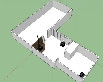

Hopefully this picture helps you out. It's a really rough sketch of the entire 1st floor. I'm still learning this software so it's not perfect. Dimensionally its accurate. I'm missing a lot more windows and doors but you get the picture. This is a layout my wife and I can both agree on. I like it because the stove in located centrally. She likes it because its pretty.
The other two locations would be in front of the large window presented in the same room, next to a door. Or in the furthest back room where I believe you suggested several months ago when I was considering buying the unit. I have these locations marked in the picture.
My only concern with this is getting heat into the rooms behind the stove. With the rear heat shield, how much heat comes out the back of this thing? I have the stove placed just over 6" from the exposed timbers. Will the brick act like a heat exchanger and work out? Should I remove a portion of the bricks as they aren't load bearing to allow more heat to pass? The big doorway next to the stove is almost exactly 48". There's no door there, just an opening framed by 8*8 timbers that are load bearing.

Honor or exceed the stove and stove pipe required clearances to combustibles and it will be fine. There will be some heat warming up the brick but most will be radiated from the sides, top and front. Would placing a quiet fan in the pass-thru window, blowing into the stove room be an option? That would help circulate heat.
