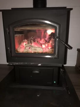

First burn in our Quad Adventure II. Very excited to see how the season goes. First time burning wood in the house. I live in central MN so should be a good test once the really cold weather hits in Jan, Feb! This board is awesome and very informative. Been lurking for years. Looking forward to contributing more in the future.
Been burning just about a month now. Hasn’t been real steady as temps still are mild. We have had some high temps only in the upper 30’s and low 40’s for some stretches. Mainly burning in the morning and evening. All my wood is 20% moisture or less. I use a moisture meter. Burning mainly hardwoods. Ash, elm and oak, some black walnut and maple. Set the thermostat at 75 downstairs and use the furnace fan to circulate heat throughout the 1,980 sq ft we have. Temps downstairs where stove is at will reach 75-80 and typically we see 72-74 upstairs.
I do not have anything to compare this stove to since this is my first stove but the Adventure II is awesome!! All night burns with nice red hot chunks of coal in the morning to get things rolling again. I will keep posting and try to answer any questions about this stove if anyone is interested. I want to do that because there is not much out there currently about this stove. Love the cozy heat, smell and ambiance this bad boy gives.

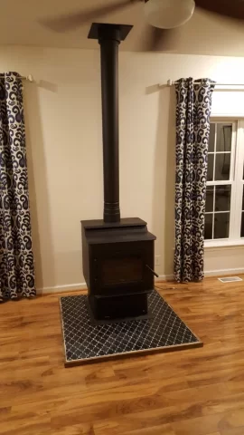

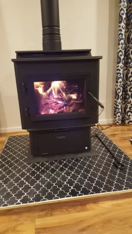

We are up and running boys!!! took all weekend but it's in. Wow this thing puts out some heat. love it so far. the Selkirk install was a dream. super easy to hook up. the roof flash was a pain. made a few mistakes but fixed it up though.

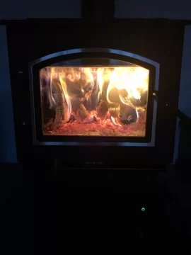

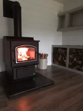

oh boy, any one have any issues with the thermostat not controlling the stove. I load and light mine then it skyrockets to 75 dag even though it's set to 68. smart burn green light stays on for 2 hr. only way for her to cool off is unplugging it.
is this normal on the start up for it to skyrocket like that? it will run you out the house. The instructions for the thermostat were poor, did it matter which screw each wire went under? also noticed in my thermostat it had a jumper between the red and RC screw. again I am brand new to burning so maybe I'm just not used to it. little paranoid.
Mine always burns warmer than what the thermostat is set for. I have been playing around with the thermostat. I have never set is for over 75 degrees. When I do set it at 75 it will get my downstairs typically to 80 degrees. So I will start it out to get everything warmed up and then dial it down to 70-72 dependent on the outside temp. If you have the blower fan option dial that down to a lower setting. I have also found that this stove really seems to hold heat well and if you plan on using the area the stove is in there is no need to load the fire box full of wood. Only add what you need to get a good fire going.
With all that said, I agree, I wish you could damper the stove down quicker once you get the fire established. It almost seems like it will continue to keep things stoked up for a period of time regardless of the set temp on the thermostat. It regulates itself once it gets to a certain point. The book says to always push the button when reloading and when you hit the button it always goes through that “fire up cycle”. I think you burn through wood faster than you really need to. In the picture below the thermostat has been set at 68 for roughly 10-15 minutes and it is still roaring pretty good and room temp is up to 77 but I have the box loaded up too. When I initially fired things up this morning I had the thermostat set at 72.
The heat feels good and I am not expecting the room temp to reflect exactly the thermostat setting as we are talking about live fire but I would think the stove would be able to damper itself down quicker.
This is good feedback and I may give Quadra Fire a call to see if they have any suggestions. Still love everything about burning wood. Love the look, smell and the heat the wood gives!
