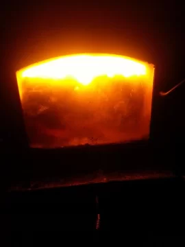

It sounds like he has good draft too. I would cut the primary air down as low as it will go until the flames start to get lazy.

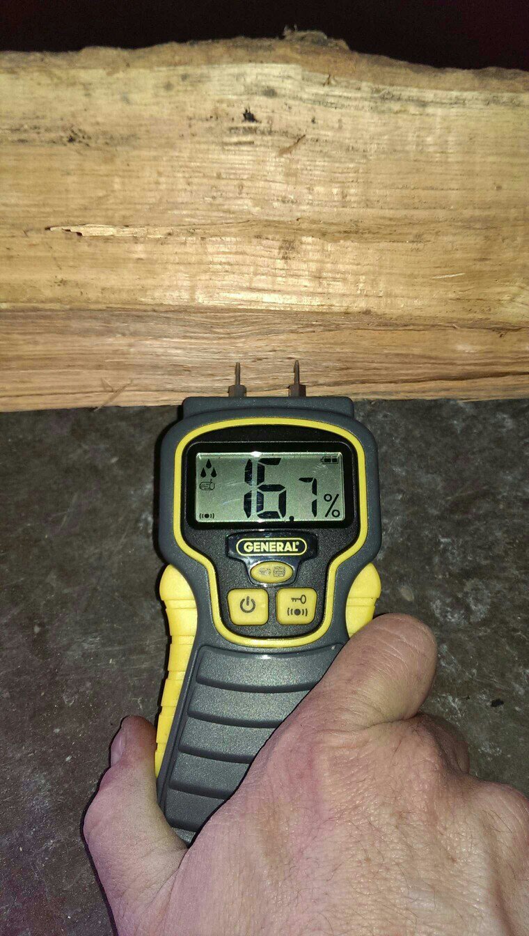

you should get yourself a moisture meter so you know if there is allot of sizzling for quite a while your wood probably isn't dry enough a little sizzle is ok. I know I will get crap for this but I never dry any wood other than hickory more than a year and it always tests 20% or less on a fresh split face I know lots of guys say oak takes 3 yrs but that is not my experience. Get a moisture meter and you will know for sure They are pretty cheap for how helpful they are.

Yes definitely get a moisture meter. I picked this one up a couple weeks ago at Lowe's for $25.
http://www.lowes.com/pd_78059-56005...l=1&currentURL=?Ntt=moisture+meter&facetInfo=
Take splits off your stack and split them in half, then read the moisture on the freshly split face. Push the prongs firmly into the wood to get a good reading.

More air will cool the fire and prevent strong secondary combustion in a modern EPA stove. Closing down the air forces a the draft to pull more strongly on the secondary air through the secondary ports in the tubes. That reburns the gases and raises the stove temp. If you have a thermometer on the stove top and pipe you will see the stove top temps go up and the pipe temp go down. That is more efficient burning and heating.

With our stove after a point the stove flue gets hotter and the stove tops out at about 500-550F. Cut back the air and the stove top heads north of 650F pretty quickly and the flue temps come right down. Not the same in a cat stove though. Of course I've never run the stove for hours like this so maybe eventually the body temp will creep up.

Good news, glad I asked. If your temps had been surface readings I would be much more concerned about your flue piping. As it is I would try reducing the primary air further and try the fan trick. It really works.
