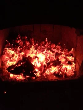

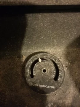

A little over 7 hours 3/4 load of oak chunks.
  • [Hearth.com] Quadra fire needs feeding every three hours!
