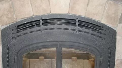

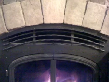

Thanks for the reply, jtp. Took me a couple days to respond, because I wanted to post pictures.
I think my facia is the "Mission Hill". As I mentioned before -- I modified that outlet restriction: see images attached. The sharper image is the earlier one (it was taken with my "real" camera), the more blurry one is from my phone camera, and it shows the modified facia.
You can clearly see that the top opening was cut at its bottom curve, and it is now flush with the top of the stove body.
Also, I'm not sure I see what inlet restriction there in the QF7100.
You mentioned in an earlier post about upgraded fan; can you provide some details/link?
Thanks!
Zevi.

That is the valley forge front.
The fan upgrade kit is to fix an issue with the cages melting. The fans are the same.
