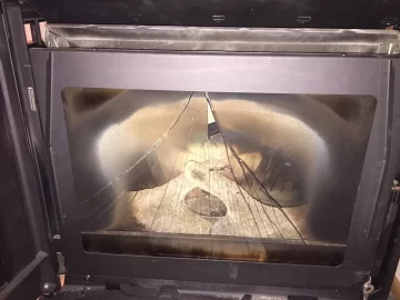

I can not tell you if it exploded with a boom or what, I woke up at 6 am after having to restart it a 12am to broken glass and flames coming out of the glass. I did not hear any sound but I also may have woken up because of the sound We have a mesh gate around it because of the baby and the door was pushed open and knocked the gate.
I did email quardrafire last night about this issue as well as the constant everyday start up problems and they respond saying they are sorry for the inconvenience and they are sure our dealer will know how to fix the issue. This will be the 2nd time in a montj the dealer tech is coming out with this being the first of this model he has worked on and there no mention from quardrafire about my concern about the glass.
Stay on them, let them know how concerned you are about this situation. Also that may just be an initial canned reply that you got thus far.

[Hearth.com] Quadrafire Mt Vernon E2 Drama and Broken Glass The morning after the Flames went out

View attachment 152637 The morning after the Flames went out
It's slightly less dramatic than ours but still unacceptable.
Tell the dealer you want them to work with Quad to get you a new stove. I would be very concerned that the shut downs and fault codes mean it could do this again - that's what ours was doing before it exploded too.
We also have a toddler so I know exactly how you feel thinking of how bad it could have been. I'm really sorry. : (
