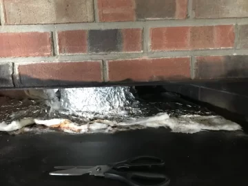

O.K.. I spoke with Buck this AM and they said no insulation anywhere. Block off plate is correct. They even suggested that I contact the dealer who sub contracts the work out, and let them know that sooner or later this guy would burn somebody's house down. Debating on this. Now I do have one more question and I will get off this topic. There is a piece of asbestos type insulation wrapping around the liner and top of stove (picture to follow) . Should I remove this as well in order to given me a better/tighter fight around the liner?

RickView attachment 231252
I would remove the wrap around the liner and then seal any gaps between the block off plate and the liner with stove cement or another high temp sealant. The key is to stop airflow up and out the chimney. Sealing all cracks and gaps accomplishes this.
Agreed on removing the existing insulation on the liner. It’s not doing anything since it doesn’t go very far up and based on them using fiberglass it’s very possible that is regular duct wrap insulation for bathroom and heating vents not stove liner insulation. I could be wrong but don’t risk it.
Edit: The Roxul should be a nice snug fit around he liner on the top of the plate. You don’t want to be able to see a gap between the liner and the plate not filled by the Roxul. Roxul a really easy to cut and work with - it will stay put up there fine if you cut it to fit. Make a hole in the Roxul slightly smaller than the liner so it’s snug.
Exactly.
But I will disagree with you, here. Don't use cement or sealant, it makes servicing anything more difficult, and is really unnecessary. Cut some roxul to match your block off plate, and set it atop the plate. Try to make it snug in the opening, and this will be your block against air infiltration.

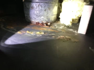

Well, I removed the foil lined insulation around the bottom of the liner and this is what I found. Lots of rust. Planning on sanding it down a little and using stove black to prevent further rust. Again, good idea or bad?
Thanks[Hearth.com] question about block off plate
