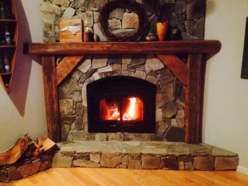

A lot to take in, hopefully it makes sense and someone has some input. I can upload some construction pics later, here's a pic of my fireplace at least.
  • [Hearth.com] Question Installing B-Vent for Zone Heating-
