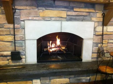

Most manufacturers use Stove Bright paint, definitely use that. As for the Mineral oil, I don't know? As was mentioned, I would think it would stink like crazy! I use it in my fireplace and never notice any smell, but I'm not sure I would anyway.
It does turn it a nice black color!
