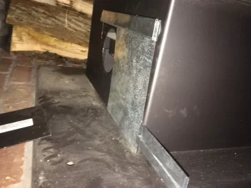

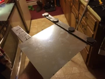

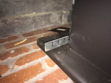

Yea I hear ya. I wish I had looked into a cat stove more. Doesnt sound like they have the run away (potential) issues/ unpredictability. Check out this link. http://gulland.ca/florida_bungalow_syndrome.htm I found this rather interesting. Especially dealing with the colder temps and increased draft vs how these new epa stoves are designed. I went ahead and made a homemade air intake damper (attached pictures) out of tin and some magnets (so its completely removeable) I find this is an extra level of control when you get a fire that doesnt seem to respond to fully closed air settings. It helps rein in a fire IMO. See what you think. pretty simple to do.

I should add, I find that with my stove, when it gets hot enough is when i get almost uncontrollable secondaries that bring it up to the 750 range which looks in my opinion help the run away fire cycle/nuclear reactor. From what i have read, the air control setting only controls the primary burn (at the wood), the secondaries are designed so they are open to unrestricted air flow/oxygen in order to get your smoke burning/efficency. (desireable-but not when its too hot) or in my opinion if you have a chimney fire. There seems to be no option to completely close her down if needed. I'll also add. I believe what happens too, when it gets that hot, the chimney has gotten hot enough that its causing the system to draft harder, thus drawing more air than is desirable. Adding a bit more resistance for a few minutes helps put you back in control.
