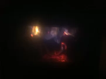

Took your advice hunting dog, this was the end result. That was all coals forward and a small poplar split. Was able to shut down 75* sooner
