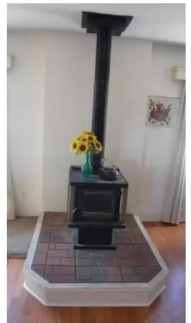

Here's my situation. I bought my house a couple years ago with the wood stove already in place. I have used it for 2 winters as primary heat. I do have propane central heat, but use the wood stove to save money. The stove seems to work ok and heats nicely, but I think it could be better and I am worried that it has reached the end of its life so I want to upgrade to a new one before this next winter. While researching , I think I may have to upgrade the chimney assembly also. I guess I'm looking for some opinions on whether or not these are needed.
Can any parts of the chimney be re-used or rebuilt or should I just replace all ?

The stove could have a lot more life left in it unless there are serious defects. Between 1998 and 2019 there were only minor changes to this model. The steel firebox is likely still in good condition. If it needs bricks and insulation pieces or a new baffle, all those parts are still available for this unit. Can you post some pictures of the insides of the stove?
Have a professional, certified sweep examine the chimney and stovepipe. If they are still in good working condition then a good cleaning may be all that's required.

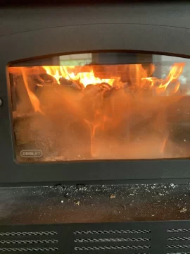

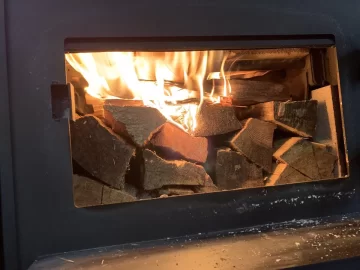

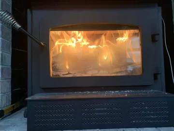

The only down side of the Drolet is the vermiculite baffle. It’s not bad you just need to be carded loading the stove.
I didn’t read to closely but 30 year old chimney should be inspected. If tax credit maxes out at $2k but that should be ok as new Drolet and chimney installed should be less than $8k so you could get the full 25% credit.
A4AB1FEA-9983-4A51-9222-4399084F3C54.jpeg 18A5C3C0-0F78-4DF0-8FB3-3F1A888A3962.jpeg 53DBCE42-EC74-43F3-8E87-5ADB140ABB44.jpeg
