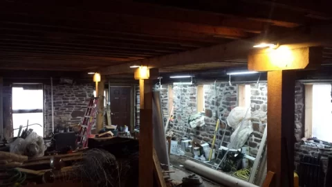

heck, you could do 3' wide pre-fab panels and use them for whatever you need. install them on a shop wall, or on a ceiling, or whatever. I have a shop space right now that I can't do anything permanent (wife would kill me if I defaced the barn) this is what it looks like now. but something I could hang from the ceiling and then remove later might be an option. gotta run the numbers.

That's some barn, I don't blame your wife..the temp panels are a nice idea, just make something small enough to easily handle, hang then from the cieling, use pex, stick a feed and return out the side of each panel, after you hang them, just connect the series together..just remember, they will get heavier when you fill them with water..
