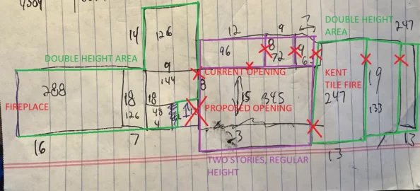

I feel like I would get blown out of the current woodstove room if I make that stove any bigger. That room is about 230sq ft, with the stove smack dab in the middle along a wall. I do like the idea of switching them though, but like I said, I would rather not use that Kent at all, or a backup backup, rather than the main stove I sit in front of while I watch TV/entertain.
I just did a quick mock-up of my house that may help explain. The bottom of the picture, is all southern exposure with almost every room having a full wall of glass. I added in the current doorways with "RED X's" and the giant red X is the proposed area where we would knock down the wall and create a large opening.
[Hearth.com] Radiant heat vs convection  for heating home
That is definitely a sprawling floorplan. What section has the 2nd floor and where are the stairs to it?
The purple area in the center is the 2 story, with 3 bedrooms and a bath on the second floor. The stairs are in the fireplace room, on the north east corner, just above the current entrance into the fireplace room. Like I said, I can heat the whole house with the Kent, but just not the Fireplace room. So I feel like a bigger stove, with that large opening added, will create a great way for the heat to travel straight through the whole house.
