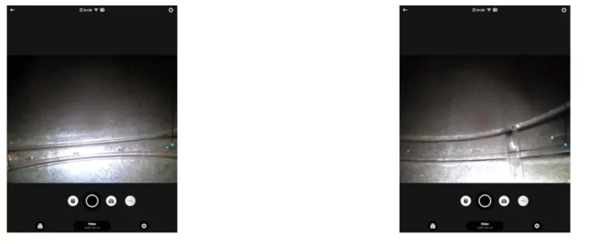

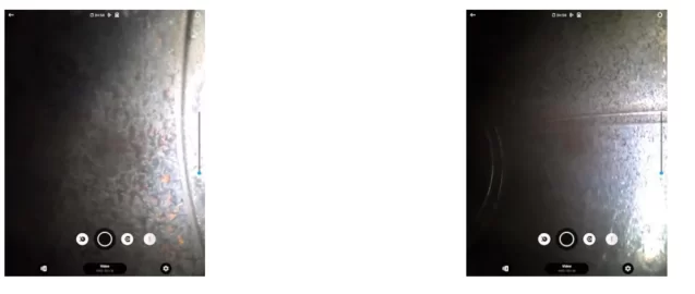

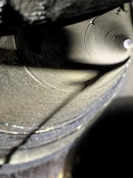

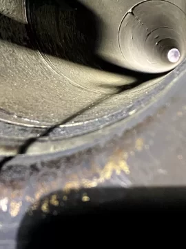

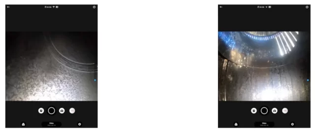

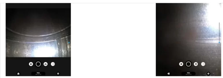

I just had my fireplace cleaned and inspected today. It's 7 years old. I was told I had level 3 creosote in my chimney and the entire chimney needed to be replaced for $4K. There is nothing towards the top he said, but it was towards the bottom near where the actual fire is. It's barely visible to me, but since he's a professional I'm trusting his recommendation. Wanted to reach out to others on here for a second opinion, and I will be hiring another company nearby to give me another estimate as well.
Appreciate any and all feedback!

They are full of crap. I don't see that much buildup and even if there was tell them to do their job and clean it. Even if it requires chemicals you never have to replace an otherwise good chimney due to creosote
Thank you for your feedback. It's barely there, but to scare me into a $4k replacement job seems a bit much for a barely used 7 year old new home fireplace. I appreciate your time!
This is infuriating! I hate it when people try to rip people off. I agree with bholler--not much there.

I’m having trouble seeing any stage 3. It actually looks pretty clean to me

There may be a little glaze there it's hard to see. But not much if there is. And regardless it can be cleaned

To my eye the pipe looks nearly brand new and is cleaner than most folks' chimneys. Do not use these guys ever again.

I'm surprised they would even provide you with pictures of what seems to be a perfectly fine chimney after saying it's a total hazard and needs to be replaced. Idiots.
