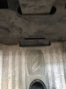

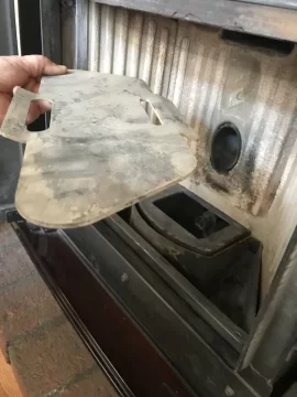

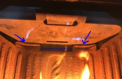

I had the same issues in my Roma insert. The baffle kept falling down and hitting the front glass. Fortunately, the tab you slide it onto (closest to you) kept it suspended and mine never fell down over the burn pot. I realized what I was doing wrong after I went to the retail store where I bought mine.
They had a Ravelli stand alone stove that wasn't running at the time, so I opened it up to see how they installed theirs. The bent tab was oriented downward, but the most important part of the installation was making sure it sits over the vermiculite plates and not ON them. Hard to describe, but in the 2nd picture I attached, this is how I used to install them, which is wrong. The 3rd picture shows arrows where the baffle sits above the vermiculite and the line across the angled tab shows how far above the vermiculite that it sits. Try to move the back tab upwards and backwards. You should feel it sit in sort of a pocket.
