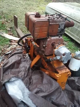

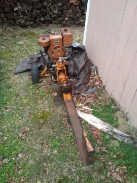

So my mother has an old log splitter we used for many years as I was growing up. I need a splitter myself but it needs some work and I am not sure of the tonnage on the machine as well as determining if it is worth rebuilding or just buying new. I called Briggs & Stratton to get a price on a replacement motor that would match what this machine already has on it. If anyone can lend some insight and maybe personal knowledge that would be helpful. I can buy a new Splitter today but they are just over $1100 by me for a decent size and worried that today's tools just arent up to par with what was made int he past. I know a decent amount of work will need to go into it, if i decide to rebuild, like all new gaskets, motor and tubing. Opinions are appreciated.

Not sure what the best answer is . . . but a couple cons would be the low height of the beam and not knowing what else may be bad or about to go bad after you swap out the engine.

The DHT 22 ton is a great splitter. Your going to drop a bunch of coin in the rebuild and you can get all the modern features on a new one. If i had the choice i would not take the time, the money and effort. Not to mention the other parts that may go bad in the near future. Once you start to throw parts into it your going to feel obligated to keep it
Reactions: D8Chumley
If you do a lot of splitting I think your better off getting a new one..you will be into this one a fair amount with a lot of unknown issues surely to rise...My buddy has one very similar to yours...it is fairly fast on small stuff but really struggled on larger stuff...not to mention being bent over all of the time was a pain.
It does look to be very basic model. It sure would make my back hurt. I expect its a single stage very low tonnage back from the first Arab oil embargo when any splitter was worth its weight in gold. Unless you are nostalgic it may be a good craigslist sale. I expect someone has a Briggs sitting around that would swap right in. These days most folks don't rebuilt a motor, they go to harbor freight and buy a clone.

It will cost more to rebuild that old brigs than to buy a new overhead valve
unit in the 5 to 10 hp. class ; if you have the time and money to restore
the old splitter then do it if not buy one of the new inexpensive units
I'd buy new.
Sell that old one and buy a new or slightly used one at a higher height.
It comes down to what you feel like spending, and how much you need a splitter. Are you sure there is anything more than just getting the engine started. These things just sit and dry up the gas in the carb. On my snow blower I pull my carb apart ever year to get it running. I can do it in 10 minutes.
Single stage pump also.
How much nostalgia does it have? How much wood do you split?
Either way, I'd get the motor running if possible. Probably good carb cleaning and minimal cost (unless you take it to a shop). It may be workablew as is. Or it is more valuable to sell if the mogtor runs and everything moves.
If its not for memories, and you splity more than say 10 hrs a year, I'd get it going , sell it off, and buy a newer and better one
Hmmm...I know what I would do, but I have been told that I am not normal (whatever that is). If you are not so inclined to do some shop work yourself, I agree with the above - Flip this thing and turn it into a shiny new model.

The price:value ratio makes no sense at all if you are paying someone to do the work, when you can buy a new one ready to run. Different deal if you are enough of a 'shop guy' to deal with any issues that arise.
If you are doing the work yourself, and are happy hacking a few different types or stuff, a $100 6.5 HP engine from Harbor Freight (cheaper to buy new than buy Briggs parts) or such, a replacement two stage pump and some plumbing, and you got an ugly but working splitter. Some time with an angle grinder and a coat of paint, and it's not so ugly.

Don't rebuild the one in the pic. Even if it was made to run perfectly, it has many, many design shortcomings. Get a modern splitter, like the DH or a Speeco. You'll be glad you did.
Thank you all for the advice. I wasn't planning on rebuilding the motor because that thing is shot. Sad to see though that motors like that were built rather well for the time and companies used more metal which is nice to see compared to today's motors. I called B&S and they said that a new motor that would be the updated model for that one is roughly $425. Add in the cost of hoses, gaskets and everything else including labor, I am estimating that the total investment would be close to $750 or so. I went to Lowes this past weekend and saw that they had some overstock splitters originally $1200 or so and now going for $950. I might just do that since they can lay horizontally or stand vertically which helps my back on those long days of splitting. I was looking up others that have rebuilt older splitters and saw people getting motors for $150 or so and saved a ton. Not the case here since I split wood annually and don't want to put cheap stuff on to only have to do it again the following year. What would a splitter in this condition go for on the market? $200? For those that asked, I am in Montgomery County not too far off Rt 309 and Turnpike. Thank you again for the insight everyone
You'll be so glad you bought new, trust me. The ergonomics, the log rest, the height, the speed. New will be so much better. That splitter's design leaves a lot to be desired. After you used it for a few hours, you'd really notice it's flaws.
