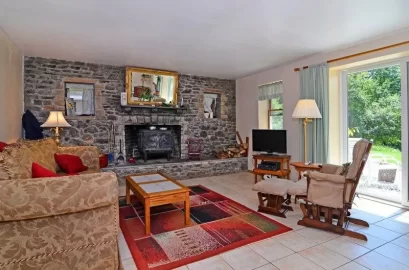

According to the inspection report, the side doors are warped and don't close all the way. The rear baffle is warped and there's a crack in the baffle plate from over-firing. And the door gaskets are worn. But the 8" flue is okay.

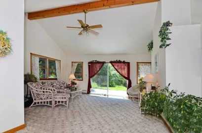

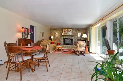

And no, I don't have any firewood :>( The house is cement block construction, a converted tractor shed, where the three bays were converted to sliding doors (all south facing). So it is now a three bedroom ranch. You enter into a 16 x 16 great room with cathedral ceilings and ceiling fan; on the other side of one inside wall is a 15 foot stone fireplace with the wood stove. There are two small window between the great room and the 15 x 30 living room with the Cawley. The dining room is open to the great room, and the kitchen is next to the living room. The bedrooms are down the hall. Total square feet around 2400. Heated with oil, hot water baseboard.
So I assume that the bedrooms won't get the heat, but there is 3 zone heating, so that should be okay. My biggest fear is that the room with the wood stove (where I spend most of my time) will get super hot and the other living areas will not. I plan to put fans in the two windows, as well as the entrance to the kitchen.

2400 sq ft is a big area to heat. Cathedral ceilings compound the issue. I wouldn't worry about overheating the place if the heat can be circulated. Did they insulate the interior and ceiling when this place was converted to living quarters?
I'm not clear on the installation. Is the Cawley already installed and is there an existing chimney in the house? Can you post a picture of the stove location? A floorplan sketch is also helpful.

So the Cawley came with the house. It's been here for years. The last couple of years there were renters here, and they just destroyed the place, including overfiring the wood stove.
There is an attic with insulation, and I assume that there is insulation in the walls... but they are thick, the size of cinder block plus framing plus siding... I'll see if I can get a floor plan - I think I drew one at one point.
Bummer, sorry to hear that. A napkin sketch is fine. I want to see what can be done to assist heat circulation and for wood stove suggestion. Home Depot and Lowes sell a good brand that will be under $1000. (Englander at HD aka Summer's Heat at Lowes) You should be able to have it installed by a certified chimney sweep for under $500 if the chimney is in good shape. That is if you want to go this route. If you prefer a more expensive stove like a big Jotul or Lopi that's ok too, just want to let you know that there are alternatives. Regardless of choice a modern stove will be much more efficient but only if fully seasoned wood is burned.
Unclear where the doorways or room openings are but I'll take a guess. If this were my place I'd place a box or window fan in the great room connecting window so that it sucks cooler air from the great room and blows it into the stove room. Run it on low speed. This will create a circulation pattern that will pull warm stove air through the kitchen and dining room into the great room. With this circulation you can install a big stove without worry of overheating the living room. To keep costs reasonable I would recommend either an Englander 30NC ($899 at Home Depot) or a Summer's Heat 50-SHSSW02 ($899 at Lowes). That should get you heated affordably. Spend some of the savings on getting the driest wood possible.
