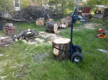

I have a trailer with ramp and a good dolly, straps etc.

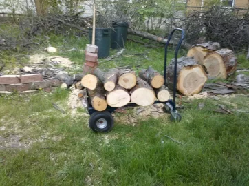

I was thinking maybe putting a small pallet, or plywood under it, but if, I take the legs off the dolly will work to.
My dolly, the handle also extends up about 18" from what U see in pic

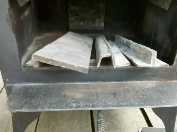

That was a good idea, already had some extra sliders , took out all the brick and some heavy metal, put sliders under ,MAN is a lot lighter now :)

Good, I'm glad it went well! Now, do you remember how all those parts go back in? ;lol
