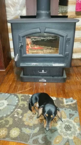

I'm wandering what I'm suppost to place this. Refractory Insulation I have a model 2000 hearth wood stove. I can seem to locate eny info on placement in the pdf owners manual nor can I find eny pictures of correct placement

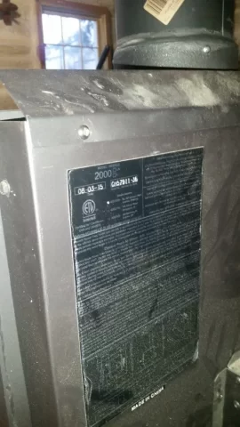

Country Hearth 2000? If so the refractory insulation is part #88146. It looks like there is only the insulation baffle board and it sits on top of the secondary tubes. It should be moved to the back of the stove.

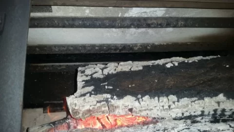

not the best picture it was running and hot IL get another when it's off of the refactoring insulation

Looks like the refractory baffle board is in place. It should be as far back as it can go. If that is where it is now then you are ok.

it's pushed all the way forward now but it's about 500 f now so when it cools I can move to the back of the heater
Good plan. It's somewhat fragile so push it back gently.
