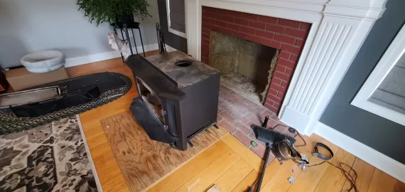

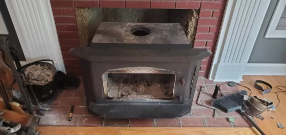

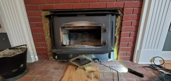

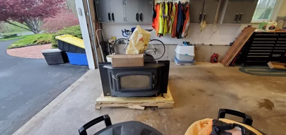

Just sharing some photos from the removal of the cracked fireplace insert. I have time so I'm going to try to do the install of my new Pacific Energy Summit LE by myself.

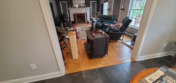

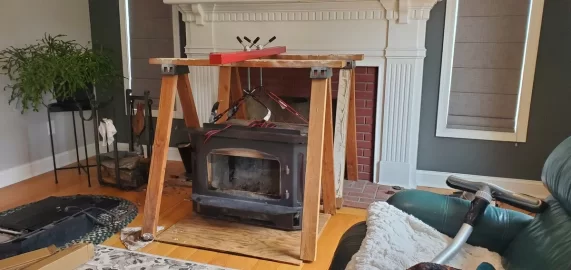

i purchased some half inch steel pipe and cut it into 6 in sections and used that for rollers under the insert. I jacked up the front and then inserted some of the rollers. She rolled right out and under my makeshift lift. Used an engine and transmission lift to get her off the ground and onto the dolly.

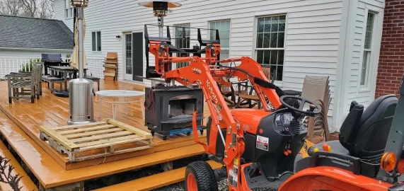

Owning a Kubota was a real blessing and it does help pay for things.
