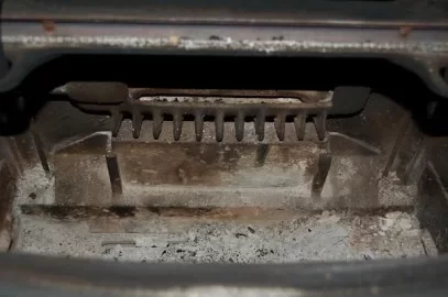

I have a Intreprid Stove. (not Intreprid II, it says only Intrepid on the side). I don't know the exact vintage, but believe it is pre-1990. It is both a coal and wood stove. It states on the underneath of the griddle: "For use with Solid Wood, for Coal use coal kit" among other things.
Can anyone confirm based on the attached photograph if the "coal kit" is installed or not? I only burn wood, and if the coal kit is installed I would like to de-install it.
This stove worked well for a number of years. In recent years it has not drafted as well. Someone suggested it might be the catalytic converter. And this prompted me to do some research. And based on my findings it appears this stove does not have a catalytic converter. Another thing which might be affecting the draft is the fact that we put an addition on our home.
If anyone could help me out in anyway I would appreciate it.
Thanks.

The coal kit is not installed. You will want to remove all the interior cast parts and firebrick, clean out all the fly-ash and soot, check and pack the seams, and then re-assemble the interior parts. Also, check the bi-metallic air control and make sure it is working properly. There is no catalytic in an Intrepid (only in the Intrepid II) but the firebricks in the back create a longer smoke path and help extract more heat from the burn. This path gets clogged up with ash and needs cleaning regularly.
An instruction booklet is available for this stove. The owner's manual is also still available on the VC website.
