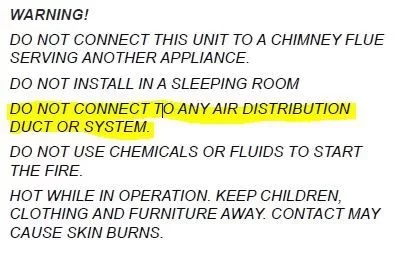

Glad that the stove is working well. Ducting the stove with a hood and blower is in direct violation of code and voids the warranty. It is also warned against in the manual.

There is no blower and the stove is not "connected" to anything. I am just gathering the naturally convected air coming off the top of the stove. I believe they are stating not to make a connection as a furnace would be directly connected to an array of duct work.
When in doubt ask the manufacturer.
I have no doubt. The hood is a great idea for convective type stoves placed in an unfinished basement. I've done it both ways and there is no comparison in efficiency to get the heat upstairs for those unable or unwilling to place a convective wood stove within the main living space. I give two craps about the safety or code police sayijng otherwise. So question: If I have no doubt, does that make me an intelligent person with no doubt or am I automatically stupid?

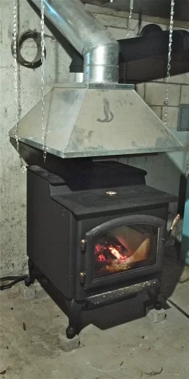

Click on the jpeg attachment and wait a short bit until it downloads. I took this at 2 pm. The stove was last loaded at 11:30 pm the previous night. Stove temp is 400*

Agreed. There is plenty potential for problems there. If you want a safe furnace, buy a furnace. It will do a better job.
You know what would be helpful here; if one of you can explain to me or others who think it a good idea as to why a hood is so dangerous fitted the way I did? Also…mellow. Do not for one second tell me what to do in terms of coming on here an exalting the factor of a hooded wood stove. I am not "selling" the idea to anyone. Anyone, including you, can come to their own conclusions based on whatever principles or factoids they adhere to. Also your around the bend inference that I am not looking out for my family is a dirtball tactic. Maybe you get away with this crap elsewhere but please do not attempt to do so with me.
Go ahead and list them. I'll help fill in the blanks.
