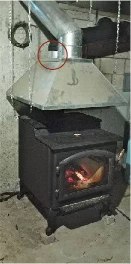

c. The return-air inlet shall not be located within ten (10) feet (3048 mm) of any appliance firebox or draft diverter in the same enclosed room or confined space.
Ok now we're being helpful. The return air is the cellar stairwell 12' from the stove. What else… and I sincerely mean that.
![[Hearth.com] report on new Quadrafire 5700 [Hearth.com] report on new Quadrafire 5700](https://www.hearth.com/talk/data/attachments/115/115998-f5553ba739b045e6d09c5eed697a7d7d.jpg?hash=cWJPZxA3O0)
![[Hearth.com] report on new Quadrafire 5700 [Hearth.com] report on new Quadrafire 5700](https://www.hearth.com/talk/data/attachments/115/115999-ea3b6d780244c272e524b699f6090d90.jpg?hash=98tsqXQ5fe)
![[Hearth.com] report on new Quadrafire 5700 [Hearth.com] report on new Quadrafire 5700](https://www.hearth.com/talk/data/attachments/116/116000-17ea918dd25c9c48404f487168797ea5.jpg?hash=eCcfVg1u9y)
![[Hearth.com] report on new Quadrafire 5700 [Hearth.com] report on new Quadrafire 5700](https://www.hearth.com/talk/data/attachments/116/116007-be3365c789d82e43af6ac71231dd66b7.jpg?hash=r6kLDRpzRK)
