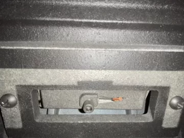

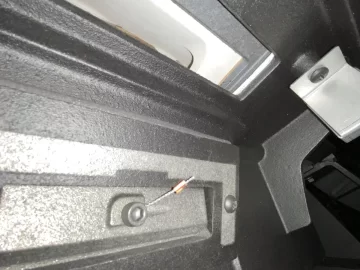

I am new to this site. My new Defiant has a very restricted air inlet damper. Will not stay up to temperature wide open unless I crack open the ash pan. Excellent draft causes great heat up with ash pan cracked open. Inspected small rectangular oval damper plate. It only opens a crack before interference from inner stove plate. Not sure how to get and keep this big thing hit. I’ll include the photo of oval damper that hardly moves.

Your aware ot's thermostatic and closes as it heats up? May have to repeatedly open it.
