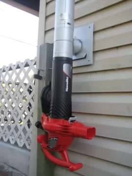

mine is outside and it's EZPZ as long as the wind isn't blowing towards me....[learned the hard way 1st time]..

What's that red thing hanging there at the bottom of the pipe?
it's a combination leaf blower/vaccum from home depot.. remove the "T" cap then it
sucks the ash residue out of my pictured exhaust pipe....

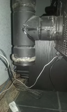

I have 3" T cleanout inside and 8" cleanout outside. I brush the pipe going thru wall and chimney with 8" brush and rods. I have 3" brush kit for inside to use this spring. I want to try the leaf blower too. I have cleaned my chimney once and it really did not need it. Some ash in pipe in wall section

actually, i go thru the inside and push any ash or residue outwards thru the exhaust tunnel with a 3" brush.
this way when i hook up the leaf blower, all or any crud is only a foot or so away from the suction..>>>>
