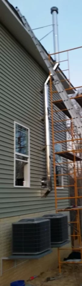

If this is an example of what you are describing yes you can absolutley do that assuming ur following manufactures instructions and code. I have not yet had a drafting/performance issue on one of these systems and have installed many. I would think draft would be affected similar to that of a rear vent hearth mount. All things being equal i agree with everyone that the straighter the run the better and usually its cheaper. Pictures would be helpful
  • [Hearth.com] Roof leak
In my class A instructions it says to never offset an exterior chimney, yet I see it constantly.
Some brands don’t prevent it. Others specifically mention it.
Some brands are fine with it. I try to avoid it because it looks like crap but sometimes customers dont want you to cut the edge pf the roof.
