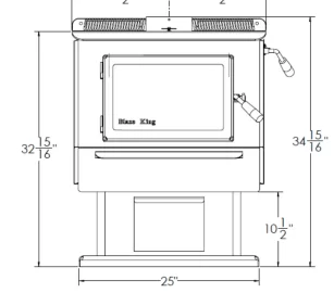

The ultra is 35" tall, the hearth is 10" tall, so I need at least a 7'-10" ceiling height to get the 49". Yikes. I don't have a full 8'. Ill probably be illegal with it.
Is that 35" from the stove top or the convection deck top? I think the ceiling measurement is from the stovetop which would give you another 2-3".
The manual says 35" to stove top. Who would have thunk that there needs to be 4 feet to the ceiling?
I'm reading 32 15/16" to stovetop.

Weird, is that the new manual? August 24 of 2015? They may have rounded up for the new manual.
I found 33" exactly in the January of 2015 manual.
and in this one:
(broken link removed to http://www.blazeking.com/PDF/manuals/en/wood/OM-PE%20E%20V1.08.pdf)
I find the 33" again. Can't find the 35" version, maybe I was mistakenly looking at the overall height.
The picture is from the Jan 30, 2013 version

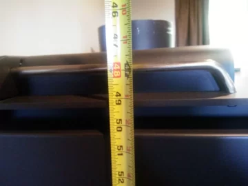

Darn thread jackers. No just kidding the more info the smarter we get. measured it tonight I am at 55.5 inches. good deal.
