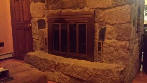

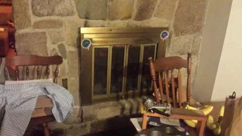

Just took a couple photos, let's see if they attach.
Kitchen side:

Living room side:

The vents do not put out any heat when using the fireplace. They are connected to some older force air ducting that is no longer hooked up. The distance between the 2 opposing glass doors is about 4.5ft, and height off the main floor to the top of the glass door opening is about 39". It'll be close to try and get a rear vent made for the stove and not have it go down. I'm certain it'll be possible.
