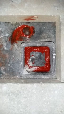

Thought I would add to this old thread while my Permatex RTV Red is drying. Adding some pictures, experiences (good and bad) and tips.
About 10 year old Pacific Energy T6, second door gasket change, and first window gasket change. Initial door gasket came loose during the first season. Unsuccessfully reglued the first time with Rutland "Clear" gasket adhesive - the Rutland Clear did not last as well, it became brittle, learned that the Rutland Clear has a lower heat rating - after two seasons of regluing the OEM gasket I decided to replace the Gasket.
I found a 3/8" graphite impregnated kit at Tractor Supply, purchased Rutland "Black" . The OEM/and Rutland Clear cleared and cleaned very easily, manually with a wire brush. Installed the 3/8" gasket using the Rutland Black - which was extremely thick black goo. This lasted for the past 6 years no failures in adhesive or gasket. Coincidentally, when reinstalling the door I recall having to make some changes in the the door latch and the door hinges. No big deal (I thought), I rationalized the gasket was slightly thinner. Stove performed pretty much as before, nothing noticeable.
Begreen's comments in a few threads regarding using OEM gaskets seemed to help him control his T6. So I decided to order both a door gasket and glass gasket. Purchased Rutland Red at Tractor Supply.
Started about 10 am this morning.

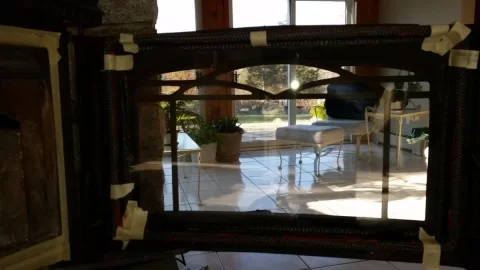

Removed door, removed window glass and lifted out the old window gasket. I put a couple of small squirts of WD40 on each of the 4 window retaining clips and removed the 4 screws without issues.
The Rutland Black was firmly adheared to the gasket channel with part of the old gasket embedded into the Rutland Black. Screw driver removed most, but I used a brass wire brush attached to my drill to remove the remainder. Rutland Black worked way better than the Rutland Clear. Vacuumed the channels and cleaned with brake cleaner that I squirted into a rag.
Replaced window glass by removing paper backing and adhering the gasket around the perimeter of glass.
TIP: You need approximately 65 inches of window gasket. Put the regasketed glass into place and replace the 4 retaining clips. I placed slight pressure on the glass and clip while tightening.

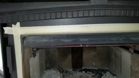

Now the door gasket. The Rutland Red has a "thinner" consistency than the Rutland Black. It was fairly easy to squirt out the 3 oz tube - too easy - the I overdid it. Tip: You only need less than about one ounce of the 3 oz tube. Starting at the lower hinge side corner, peel the paper back as you go carefully around the perimeter with out stretching and carefully round each corner without twists etc. I used masking tape as I went securing the gasket to the door frame which helped keep it from pulling.
Before I replaced the door onto the stove body. I took some masking tape and put it on the stove body where the new gasket (with too much Rutland Red) would be touching the stove for fear of the door getting stuck to the stove. I used some of the remaining Rutland Red to seal a loose bolt on the stove floor as well as healthy amount around the ash chute trap door as I believed both of these spots were leaking a bit of air into the stove. I do not use the ash chute, and even with it filled with ash, that area seemed to "glow" a bitter hotter than other areas.
Gonna let it sit for a half a day, temporarily open and closing. Then put an extra firebrick over the entire ash chute and bolt opening and build a small fire to further cure. Door hinge and latch will need to be fine tuned for the new gasket.
Now about three hours after applying the Rutland Red, it will not stick to your fingers when touched and begun to cure.
Major take home for me was the Rutland Black worked - Rutland Red was messy because I used too much.
