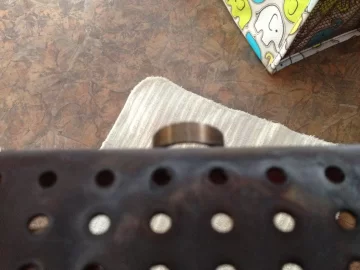

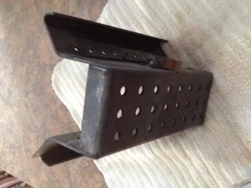

I dont know what else to do ---- any suggestions, bad temp sensor possibly? Only other thing that I am waiting to remedy right now and not sure if this would make an enormous difference or not but the burn pot assembly has a gasket on the back side where it attaches to the ignitor, I could take a pic if it would help but basically the back of the burn pot has a short cylinder sticking out the back that fits to the ignitor, on the bottom of that piece that juts out ont he burn pot there is a small opening about 1/4 inch long and probably an 8th of an inch wide .... there is a round gasket that fits into that cylindrical piece which I currently do not have installed ---- beginning of this season it fell out and was basically disintegrated, I didnt think it was a major piece so I never replaced it. I have since ordered a new set of gaskets from SBI (last week) and they will be delivered on Monday. Coukd the absence of this gasket be causing my H1 / overheat problems????
Heres pics of the burnpot and the piece that is missing the gasket, again I cleaned everything I could think of. Fan blades on combustion and exhaust blower are very clean however I took a brush and cleaned them even further ........ got a flashlight into the combustion blower chamber after vacumming and it is spotless ...... everything looks as clean as can be, exhaust pipe going out has no blocks, air intake coming in has no blockage - clean as a whistle.

PM me your email address and I'll send you a tech sheet to show you how to clean your stove in depth. It may be you missed some spots.
Also, remove the filters from the 2 pancake style Heat exchange blowers. Most people dont clean those often enough and we find after a while they cake up. If you have dogs or cats they cake up really fast. Bring the air damper to the minimum setting.
The gaskets you are talking about are to seal air leaks around the igniter. Nothing to do with your overtemp.
