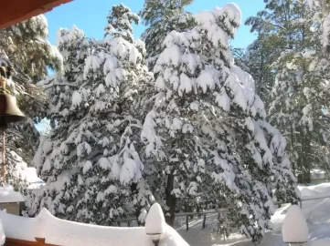

It's about anywhere from $200 to 250 dollars a chord . $200 for shaggy juniper . We have some oak in central Az. Arizona White Oak, Live Oak, Blackjack Oak, Gamble Oak and Emory Oak to name a few. (Most Arizona Oaks are of the RED OAK types).What's really weird is some of the varieties don't drop their leave until spring when new growth starts . I not sure what variety they are ,but in heavy snow it tends to break limbs . We have a lot of oaks with spindly trunks . This is a picture from a month ago with snow on a alligator juniper in my back yard . Temp 0 degrees
Cool, beautiful picture.
