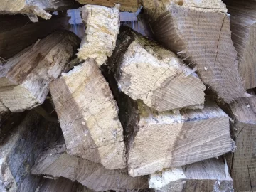

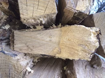

I just got done splitting the 28" rounds of an oak tree we took down 3 weeks ago, it has been dead so long (maybe 20 years) all that was left was the trunk about 35" tall, no limbs. There is a ring of rotted wood around the perimeter of the rounds about 2" thick, after splitting the rounds into small pieces the MC is still 25%. So this proves to me it doesn't matter how long a tree has been dead it won't completely dry until it is split and stacked off the ground. So much for the wood I thought was a no brainer to burn in two weeks.

I just got done splitting the 28" rounds of an oak tree we took down 3 weeks ago, it has been dead so long (maybe 20 years) all that was left was the trunk about 35" tall, no limbs. There is a ring of rotted wood around the perimeter of the rounds about 2" thick, after splitting the rounds into small pieces the MC is still 25%. So this proves to me it doesn't matter how long a tree has been dead it won't start to dry until it is split and stacked off the ground. So much for the wood I thought was a no brainer to burn in two weeks.
Well the fact it is at 25% moisture content proves that it has already dried some while standing dead. A live oak would be over 30% maybe over 35%. So although it's not ready for the stove it's closer to being ready.
No doubt splitting any wood excelarates the drying process.
You ever cut a log and have water gush out of the cut? I bucked a dead standing oak and hit a pocket full of water. Everything gushed out and I thought I broke my saw for a second.
In case you and 2pistolpacker aren't aware, oak runs about 70- 80% green on the stump.
If those logs had been stored off the ground and under cover for 20 years they'd be dryer than popcorn farts
Rain water.
Cut it, split it, stack it, take a MM to it, you'll be rather surprised at how fast that rain water dries out.
You might notice how much lighter splits from the top of that 35 foot pole are compared to the bottom.
We processed 20 cords of dead standing oak last year. One half in November, one half in January. The stuff I stacked and measured at 23-27% in November was at 17/18/19 in february. Was nice as we used up the four cords that should have been more than enough if last Winter hadn't been unusually and persistently Winter-like and burned about a half cord of what we had cut in November.
