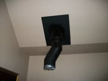

I had a wood stove with Selkirk pipe running through the roof. I took out the wood stove and am replacing it with a Breckwell Big E unit. The Selkirk double wall pipe extends about 12 inches into the living room. The Big E came with Duravent piping- Is there an adapter that I can use my Duravent pipe with the Selkirk pipe? Otherwise I will have to use Selkirk pipe exclusively -Thanks for your help-Rolf
I DONT mix different brands. I am not saying it cannot be done, but I would not want to risk my house and my family over this.
Take the 6 in. stove pipe and the stove pipe adapter off
the 6in class a chimney . install a 6 to 4 in pipe adapter and
install your supplied pipe
There is no Selkirk to Duravent adapter. Return the Duravent or take out the Selkirk. :-)
