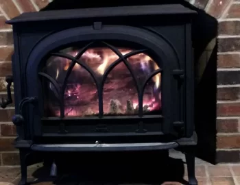

I agree, the light show is almost better then a fireplace when the secondaries start blazing away! Just try to imagine the heat this oslo is throwing with this burn!
[Hearth.com] Selling house, no more Pellet Stove! Fireplace or Wood Stove?
Although I don't have the Jotul Oslo, I don't have to imagine what kind of heat it is putting out. When my liberty is burning like that it is putting out a ridiculous amount of heat
