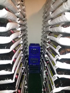

Yup its true,... these things just burn too dam hot!!!!,.... I cant turn my stove down enough without getting inconsistent feed. If i put the stove on 2 it'll get too hot a trip the disc,... if I put it on 1 then I run the risk of the fire going out (which has happened several times),.. I like Stove Chow better,... they last longer with a more consistent heat. So I paid 209 per ton,... the floor is open for bids. Between Newburgh & Poughkeepsie NY [Hearth.com] selling my stash,...4 ton of Somersets
