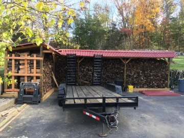

This is my driveway 8 cord shed, each section is 10ft long, 5ft wide and 8ft high to 6'6 in that back, each bin hold 2 cords, its only 3 rows deep to help facilitate drying.
