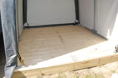

Well I bought one and set it up this weekend. I made a 2x6x8 pressure treated frame.Floor was decked with 2x8x8 . I'll take pictures tomorrow. I have 5 tons coming friday. I hope it all fits. I am going to hand stack it in there. It will sure beat just putting a tarp over it! The 8x8 foot shelter logic cost me $239 and I have $140 in the floor, For a total of $379.00 Was cheaper then I could had build a shed.

Ya I heard the same thing. That they do get condensation in them. Its up off the ground by being on a platform. I also gaped the boards on the floor a little hoping to get some airflow thought that. But I may install vents on either end. Im going to leave it zipped up while we are now in August to see if I get ant condensation. Time will tell i guess.

Back to the original subject............Sounds like a great idea to me. Nice floor you built too. I store my boat in a 12 x 20 one of these ($299 @ BJ's) and I find most of the snow slides right off if you keep the tarp tight. Whatever doesn't comes off with a little push from the inside.
If you don't get the circulation that you need you could always remove a few floor boards and drill some holes in the side of the floor frame. Moisture buildup would be my only concern.
