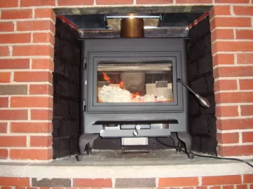

Nick, glad you will install a block-off plate....
Do you NEED a block off plate? No. Your insert will still work. But a block-off plate took this newbie just 2 hours to build ($25 for materials at Home Depot) and install, and it is the right thing to do. I insulated my liner, and installed Roxul on top of the block-off plate, the smoke shelf, and underneath the top plate.
I have an outside brick chimney with a short run- so I wanted all the draft help I could get.
I am happy to say that I measure ZERO degree difference in the bricks on the outside chimney- all the way to the top. The bricks are the same temp as the outside air. A few times it got too hot in the house, I just opened a window. The point is- I am in control because of the block-off plate and insulated liner.
The reason I did this myself rather than hire a company is that the first two companies each told me that I did not need a block-off plate. Warning, Will Robinson! I'll do it myself and leave the no-talent arse clowns to their B.S.
