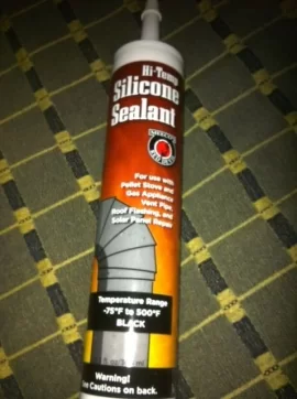

    I bought my class A chimney today. Also picked up this Hi-Temp Silicone Sealant. Rated -75F-500F. Seems like this should work to seal the storm collar that is located just above the roof flashing cone. No? Rated to 500F high enough rated? Suggestions??
    Thanks in advance.

    We just installed ours today and used regular silicone sealant. The Class A pipe outside temperature was at around 130 Degrees F at high fire.

    That'll work just fine.

    Thanks again BeGreen. After reading another post about the chimney pipe being about 130F, this is probably a little overkill. Though it will work. This will be my first class A chimney, so not really sure what to expect exactly. Masonry chimneys just don't get hot on the outside. Wasn't sure about the metal, even with the insulation.

    We use a 2" aluminum foil tape with a caulk on the back, it's called various names, putty tape or hard cast tape. It outlasts silicone by a long shot. The foil protects the caulk from ultra violet rays and deterioration. We sell it for .55 cents a foot.

    You can buy it online at www.hechlers.com in the online store. Look under gasket kits and maintaince items. Otherwise you might check with a heating and cooling supply house. You need to make sure it is the foil with the caulk on the back and not just plain foil tape. This stuff is amazing, once applied it does not come off. I have some on my stainless steel chase top that has been there since 1987 and still is holding.

    General information. Regular silicone caulk is rated at 400 °F , or at least every brand I have checked is.
