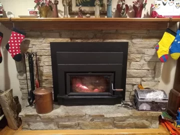

So 3 weeks into burning this has been a revelation. Today is the first really mild day since the install. But the furnace has been pretty much exclusively used to circulate air. Most of my splits are a bit on the long side so it's been more E/W loading than I was hoping for, but have managed to keep the slightly shorter splits for overnight packing the stove n/s.
Overnight burns have been great. High burns for 8-9 hours and medium around 12. Still dialing in everything and will keep working on packing wood in tighter and getting my hands on higher but wood, with some locust coming my way.
The appearance has inspired a few others to look at it for their fireplace and the performance has had some friends looking at new blaze kings to get better burn times.
Install had a few bumps on the west with delays in shipping from Washington then inclement weather, but finally with the existing stonework not providing for a flush mounting. Installer did a great job fabricating a steel plate surround to match the stock. Ended up looking great.
Will update as I get more experienced with it. Also will post a review in another month when I feel more experienced with it.
Only thing I'd like is the flush look with a larger firebox. The princess had been a non starter with my wife so very happy with my new insert. Definitely a huge difference with 5-7% moisture content to 14-16% though. Trying to mix and match on both types.

Sounds great so far and thanks for sharing
Would you say you're doing more hot burns (medium or higher?) than the real low and slow? Your glass seems doesn't seem to bad thus far.
